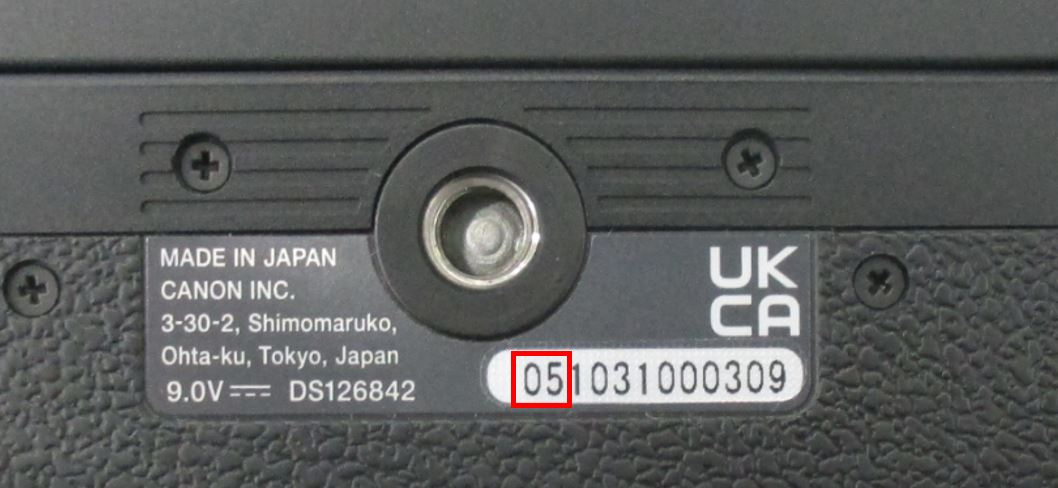

Thank you for using Canon products. Concerning the Mirrorless Camera EOS R10, the following phenomenon has been confirmed. Customer support for this phenomenon is described below. We would like to offer our sincere apologies to any users who may have been inconvenienced by this phenomenon. Phenomenon Certain units of the EOS R10 camera may exhibit a loud crackling sound when the built-in flash fires. Affected Products EOS R10 If the first two digits of the camera’s serial number are between 01 and 10, the camera may be affected. The serial number is located at the bottom of the camera, as shown below with the first two digits highlighted. ![]() How to check if your camera is affected:
