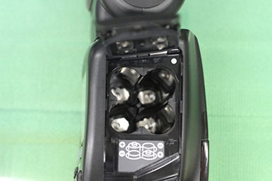

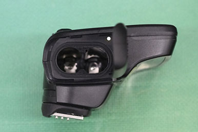

However, even if the serial number is within the ranges above, the unit is NOT affected if there is a round, white dot at the top right of the battery compartment as shown in the photos below.
